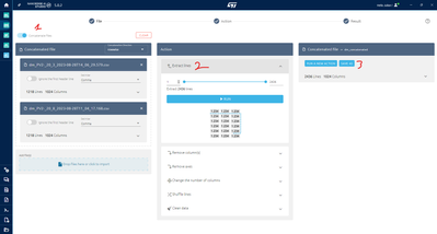

For now, because you are doing anomaly detection, I would suggest you using the Data Manipulation tool to merge the files into 2 files: Nominal and Abnormal (you can do more, but not 533). To do so:
  1. Import all your nominal files
  2. Click concatenate
  3. click extract lines
  4. click save as
Then do the same with Abnormal data.
Thank you for making us aware of this issue
Have a good day,
Julian
  4. click save as
Have a good day,
Julian
