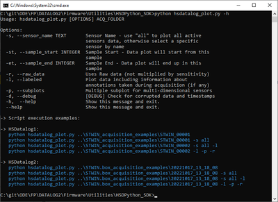

Hello @FilipeLourenço
You can execute the scripts in your preferred Python environment (i.e.: use the command python hsdatalog_plot.py).
You can also discover the complete list of parameters for each script by executing with the –h option (i.e.: python hsdatalog_plot.py –h).
Best regards

Hi @SimonePradolini,
I just had a lor of error messages running in python IDE like Pycharm, and proceed to just use the command line.
Thanks for the help
