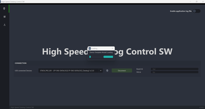

I am using the STEVAL-MKBOXPRO development board with the FP-SNS-DATALOG2 software V2.2.0, and i already checked that i have all the right versions of
However, i am still getting the message "Device Template Model Loading".
Do you have any other recommendations?

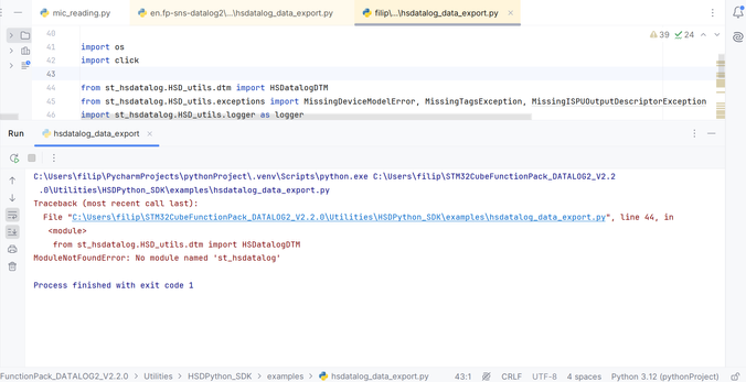

Then i discovered the hsdatalog_data_export.py but i am getting a lot of errors like this:
I already had the same problem with the module click, but i managed to install it on PyCharm and was fixed. But with this specific modules from Python SDK i don't know what to do.
The above errors mean that you didn't install the SDK. See the log in PyCharm: if the script you launched isn’t finding 'st_datalog', it means that you didn't install it.
Are you familiar with Python? I suggest you make this experiment and reinstall HSDPython_SDK from scratch:
You'll see all dependencies automatically solved with no error messages and you should be able to use the HSDPython SDK.

We have tried to replicate your setup in our lab, but we were unable to reproduce the error. Everything works correctly on our end.
Which Python version and OS are you using?
In addiction, could you please share a screenshot of the stuck Python GUI? This would provide us with more information to support you more effectively.

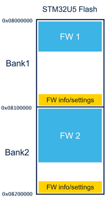

I'm sorry, but the only reason you see v2.3.0 in the dropdown menu of connected boards is that the board is flashed with firmware version 2.3.0.
Have you ever flashed the firmware on your board using the mobile app "ST BLE Sensor"?
Since STM32U5 microcontroller families support double-bank flash memory, when the firmware is flashed using this app, it is automatically loaded into the second bank, and when the flashing process is finished, the bank is switched, and the firmware is set to boot from the second bank.
If you then tried to reflash the firmware (v2.2.0) via USB, it might be that you flashed it to the first bank.
This would explain your issue with the GUI because the firmware that boots remains the one previously flashed with the "ST BLE Sensor" app (presumably v2.3.0) due to the swapped banks.

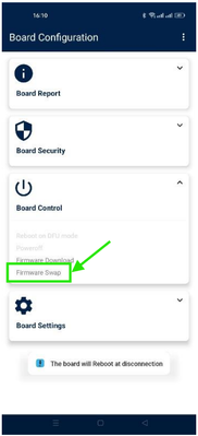

If this is the situation, you can easily swap the memory banks from the app by selecting the "Firmware Swap" option in the "Board Control" section of the "Board Configuration" menu.

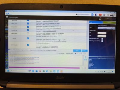

I tried to flash using the mobile app, but as far as i know without sucess. But i have flashed the board via usb using the STM32CubeProgrammer previously, and maybe i flashed the v2.3.0.
I used the app and saw that i have 2 versions and the current firmware is the v2.3.0. I tried to switch the firmware in the app but it keeps showing v2.3.0 in the GUI.
Then i tried to do it Via STM32CubeProgrammer app in Option bytes> User Configuration > SWAP_BANK or BFB2, but get an error and, after that, when i turn on the device there is no light that stays on , as usually, and can detect the device on GUI or STM32CubeProgrammer or in the apps.
Thanks for the help.
