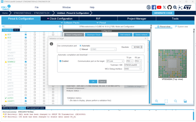

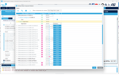

To do it in CubeMX:
  1. Select the board
  2. Activate X Cube AI
  3. Select the validation template
  1. Import your model
  2. Click validate on target
  3. Set the baudrate to 921600
  4. Enable the automatic compilation and select STM32CubeIDE
Make sure to set the boot pin of the DK board to the right before plugging it with a usbC to usbC cable
Have a good day,
Julian

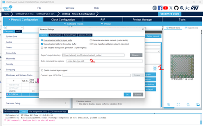

To do so you can add the following argument to the validate:  --input-data-type float32|int8|uint8 (int8 only in your case).
If you do it with the CLI it is straightforward.
If you use X Cube AI, you can click the options and add the argument here:

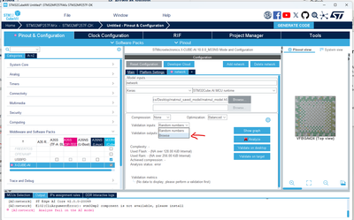

You can also import your own testing data as a npy file containing the test data and labels.
To do so, click browse on the X Cube AI interface:
