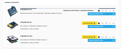

Hi, Im working with the ST EDGE AI Developer Cloud and since the last monday Im having some problems with the benchmark, they got stuck into this infinite loading...
Its still possible to download the final files, but the benchmark tools are really useful to know if the model is going to work "well" in the boards.

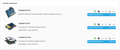

Yes, it's working properly now, thank you!
