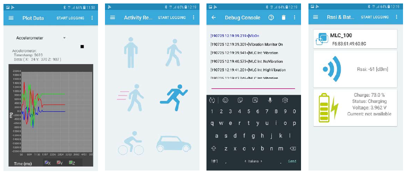

The LSM6DSOX is one of the most innovative products in ST MEMS Sensors portfolio. And, of course, is onboard on the ST.box. Two pro-mode application directly shows part of the capability of this product:
For debug purposes, as side feature, note also that both BLELowPower and BLEMLC applications enables the USB Virtual Com Port (VCP) to visualize printf to a Terminal (for example Tera Term) to control the initialization and connection phases and, at the boot, to define the name the STEVAL-MKSBOX1V1 will use for Bluetooth advertising. To enable the VCP, it is necessary to recompile the code, enabling the compilation define called STBOX1_ENABLE_PRINTF at the beginning of the BLELowPower/Inc/STBOX1_config.h or the BLEMLC/Inc/STBOX1_config.h file.
