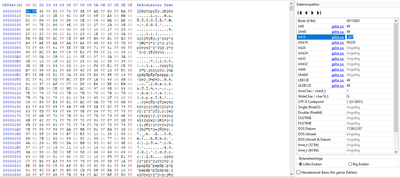

Using a freeware hex editor i opened the .dat file and this is how it looks:
As the samples are saved in a 16-bit integer (according to the mic's datasheet), which corresponds to 2 bytes, im expecting to read 0x31FF. This is valid since the HSDatalog software also presents the same value in int16 (e.g. -207). This is what i have tried so far in STM32CubeIDE:

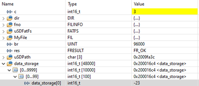

DIR dir;
FILINFO fno;
FATFS uSDFatFs;
FIL MyFile;
UINT br;
FRESULT res;
char uSDPath[3] = "/";
static int16_t data_storage[48000] = { };
/* Working with ...\raw_data\192kHz\1bar (for evaluation)\phi_1_l_20*/
if (BSP_SD_Init() == MSD_OK) {
if (f_mount(&uSDFatFs, (TCHAR const*) uSDPath, 0) == FR_OK) {
res = f_opendir(&dir, uSDPath);
if (res == FR_OK) {
for (;;) {
res = f_readdir(&dir, &fno); /* Read a directory item */
if (res != FR_OK || fno.fname[0] == 0)
break; /* Error or end of dir */
if (fno.fattrib & AM_DIR) { /* Directory */
printf(" <DIR> %s\n", fno.fname);
} else { /* File */
printf("%10u %s\n", fno.fsize, fno.fname);
res = f_open(&MyFile, "STWIN_00001/IMP23ABSU_MIC.DAT", FA_READ);
if (res == FR_OK) {
res = f_read(&MyFile, data_storage, sizeof(data_storage),
&br);
static int16_t read_buff[100];
// f_gets(&read_buff, 100, &MyFile);
// unsigned char c = fgetc(&MyFile);
// int16_t c = fgetc(&MyFile);
char_t c = fgetc(&MyFile);
if (res == FR_OK) {
// Successfully read into data_storage
printf("Read %u bytes from the file.\n", br);
} else {
// Handle read error
f_close(&MyFile);
Both methods (using fgetc or f_read) for reading the file content provide different and wrong results

I guess you used FP-SNS-DATALOG1 to log data. If so, be aware that .dat interleaves data and timestamps as described in the User Manual (DATALOG1 chapter 2.6.5).
By exploiting the DeviceConfig.json you can interpret the .dat file and export data in the format you need.
Moreover, you can use the provided Python SDK that already contains ready-to-use scripts for process and export .dat files.
