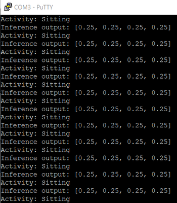

I am working on a Human Activity Recognition model with a STMU585CIU6 using Cube AI. In summary, my model takes accelerometer data from my lsm6dsox sensor, and use a frame of 2s of sampling (for ODR 104Hz, it takes 208 samples) as input for the network, which return a prediction among 4 different classes.
After struggling for some time to use the generated functions in my main.c, I managed to perform the inference, but not as I expected. I reached a point where I'm not being able to identify and solve the problem.
I left my board on the desk to run some inferences, and as you can see in the image, the prediction values are the same for all the classes.
I would really appreciate if someone could help me to identify what could be possibly wrong. I am mostly suspicious about the network weights/parameters initialization, but I can't really figure it out. Here is an adapted snippet of my main.c:

Your problem seems to be at least the weights, you should call the ai_network_create_and_init with NULL as the third parameter. The weights are generated automatically by the code generation tool in the file network_data_param.c
ai_network_create_and_init(&network, acts, NULL); Here is the pointer to the documentation Documentation/embedded_client_api.html#ref_api_create_init inside the package (normally under ~/STM32Cube/Repository/Pack/STMicroelectronics/X-CUBE-AI/<version>
Regards

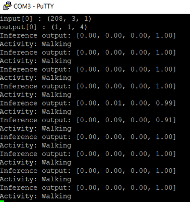

Hi Daniel, thanks for your reply. I had the third parameter set as NULL before, but my problem still persisted. Instead of getting the predicted outputs equal for all classes, using "ai_network_create_and_init(&network, acts, NULL);" gives me an inference output like that:
Moving the board or not, the prediction remains dominant for a wrong class.
