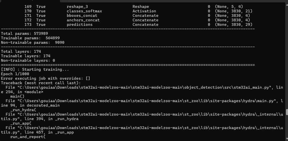

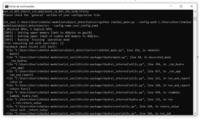

2024-09-03 10:12 AM
Thank you for your response.
I tried using Model Zoo, but I encountered the errors shown in the attached figure. I haven't been able to solve them.
Best regards,
2024-09-03 11:22 AM
Can you share a higher resolution picture with the last part of the error ?
Did you try the default yaml file to train the ST ssd mobilenet v1 model ?
You just need to change the dataset section with the path to the dataset and possibly the classes.
Keep the model_path empty has the model will be generated.

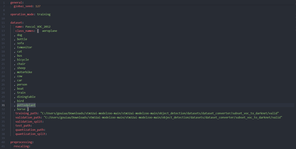

2024-09-03 11:39 PM
It seems your dataset is not loaded properly as you can see 0it in the trace.
Note that the dataset for object detection shall be with the YOLO Darknet format. There are scripts to convert datasets in COCO or Pascal VOC format to YOLO Darknet format in https://github.com/STMicroelectronics/stm32ai-modelzoo/tree/main/object_detection/datasets

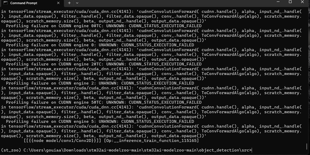

2024-09-17 9:16 AM
hello mr ST employee
so i managed to convert the pascal dataset to darknet . but when i tried to train it . i had various errors about CUDNN when i reached the phase of 1/1000 epoque
so do you have any idea how to solve this error??
