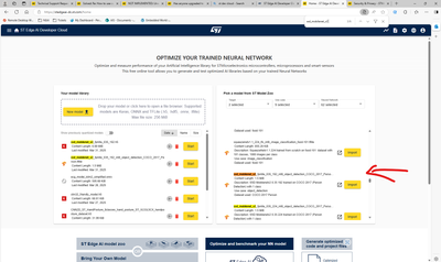

2025-04-01 12:46 AM - edited 2025-04-01 1:30 AM
Hello @Anhem ,
There is indeed an issue with this model for some reason.
I am investigating this matter.
Alternatively, you can select another model or download the already quantized model (that works):
Have a good day,
Julian
