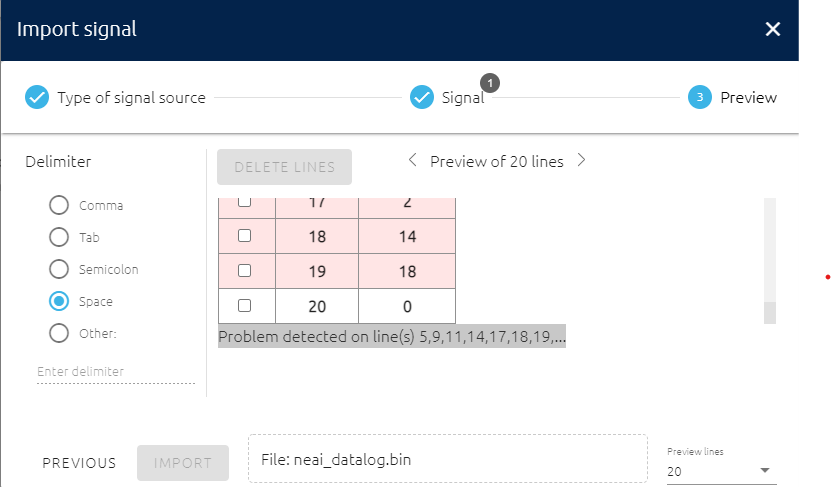

3. Regular Signals: Add signal-> From File -> Choose the neai_datalog.bin which is generated in STEP#2 -> continue but with followed capture's error: problem detected on line(s) 5.6.7.8,xxx.

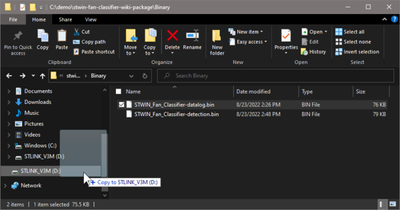

The binary file is to be flashed on your F401RE to be able to log data from serial. Here you tried to import code for microcontroller as an input file containing data.
You can find a tutorial here where everything is explained: https://wiki.st.com/stm32mcu/wiki/AI:How_to_create_a_multi-state_vibrations_classifier_using_NanoEdge_AI_studio
Basically, the steps are:
(example with a STPROTEUS)
Have a good day,
