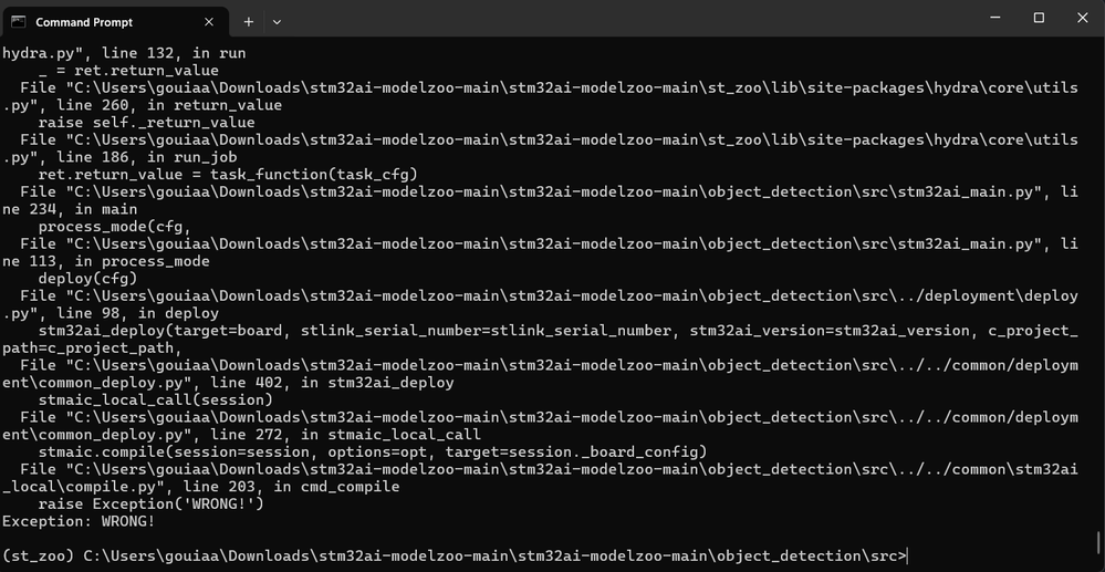

i need some assistance with modelzoo . so first of all . i converted a dataset to darknet using converter.py than i trained it using train mode i had a 2.6mo .h5 file then i quatized it to 600kb .tflite file. but when i tried to deploy it i had an error saying just exception "wrong" from compile.py file.
so is there any assistances about this error
