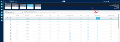

In version 5, how can I check the Emulator section like in version 3?

As for the emulator, in version 5, you can find it here:
Have a good day
