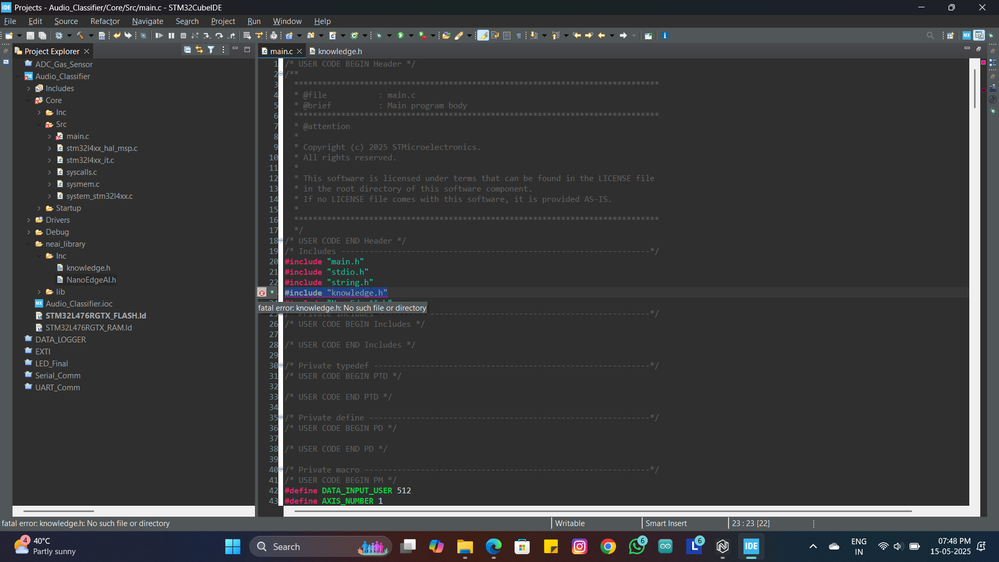

i classified the recorded sounds as Crying Baby, Ambulance Siren, and Noise. I deployed the library and got a few files mainly "knowledge.h" and "NanoEdgeAI.h". But when I include them in my main.c file I face the following error.

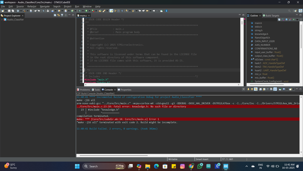

../Core/Src/main.c:23:10: fatal error: knowledge.h: No such file or directory
23 | #include "knowledge.h"
compilation terminated.
make: *** [Core/Src/subdir.mk:34: Core/Src/main.o] Error 1

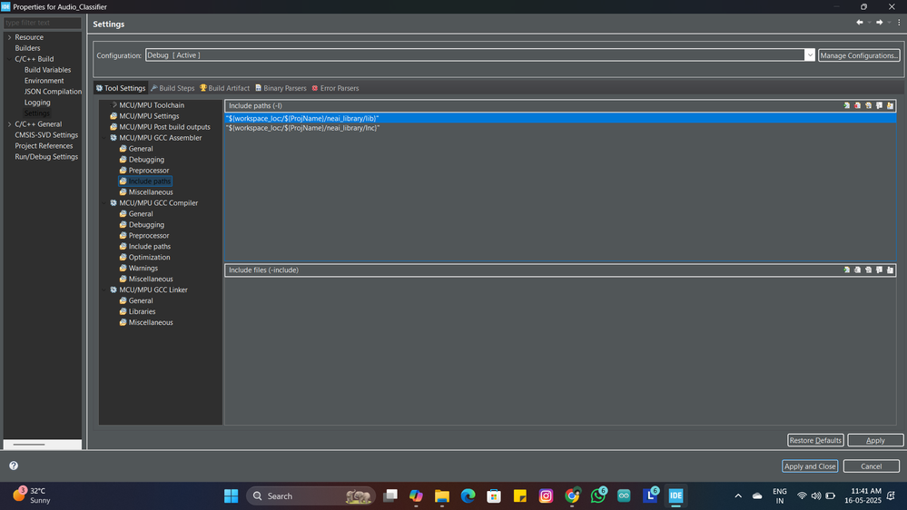

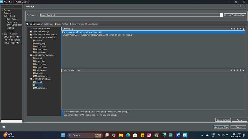

I am attaching the included paths, so it would be easy to communicate.

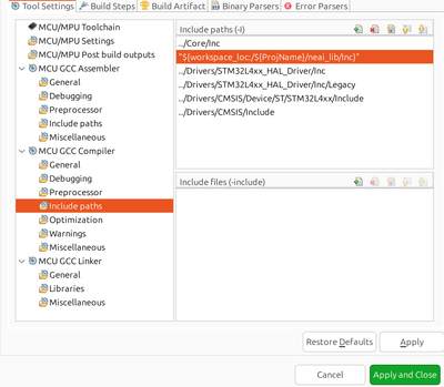

Hello @Cipher626,
It seems to be a setting issue
Try to add this: ../neai_library/Inc in C/C++ Build -> Settings -> MCU GCC Compiler -> Include paths
Have a good day,
Julian
