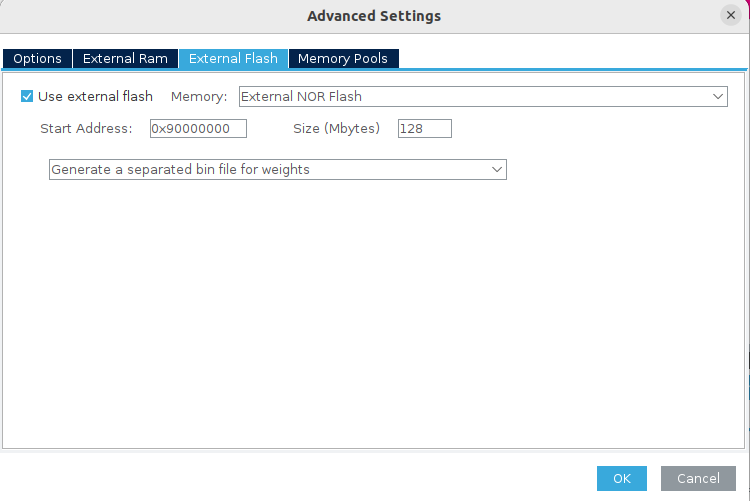

Practically, I observed that if all the parameters are in the internal flash everything works fine and there are no nans in the metrics. If I choose to put the parameters in the external flash as in the figure, there I get the nans (I was doing it since the model was too big for the solely internal flash).
To use the external flash, I enabled the QuadSPI for the M7, I don't know if this information could help in some way.

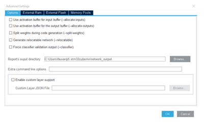

Hello
Accuracy stands for "Classification accuracy". It might be NaN if ST Edge AI Core does not detect your model as a classifier.
You can force this with --classifier argument (Advanced settings)
Find more in page 20, 23

Hi @hamitiya ,
I have already tried both with the option enabled and disabled. Unfortunately, the result doesn't change.

I did as mentioned above, placing the entire quantized model in the "extended" internal flash memory. The code runs and the validation completes successfully. I really think there was some issue with using the external flash memory...
