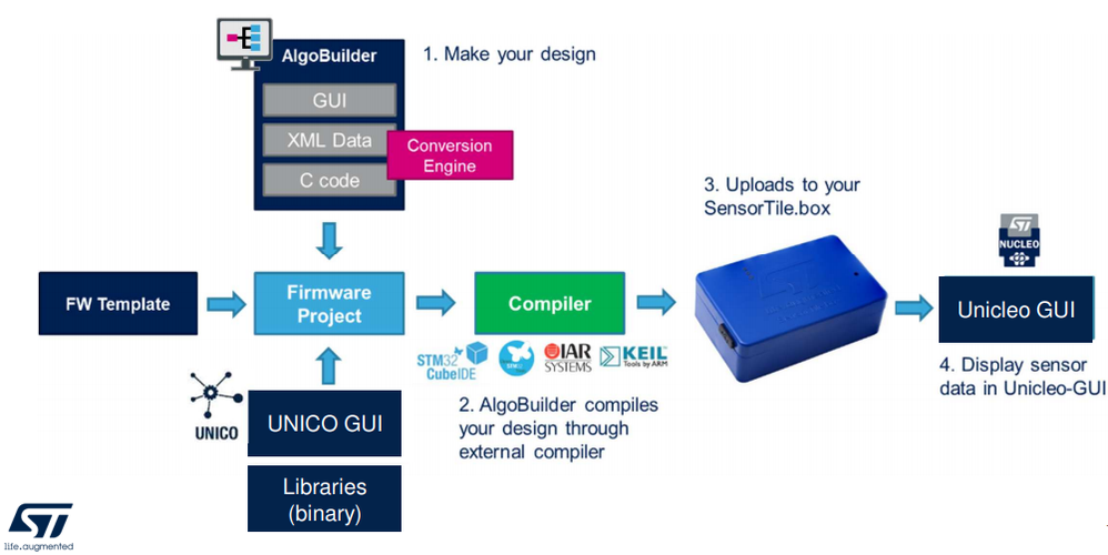

On May 12th an interesting Webinar was presented on the smart use of the Machine Learning Core embedded in the X-family IMU sensors, such as the LSM6DSOX mounted on the SensorTile.box board.
The main example proposed during the webinar is related to the use of the SensorTile.box together with ST tools (Unico, Unicleo and Algobuilder softwares) that can be freely downloaded from the st.com website.
The video examples available in the webinar documentation show step-by-step the whole process for the implementation of the artificial intelligence function on the SensorTile.box tool, from the data acquisition and the data-set creation (a "Mode 1" use of the SensorTile.box board) to the direct configuration of the LSM6DSOX sensor and data acquisition through Unicleo and Algobuilder softwares (a light but very effective example of "Mode 3").
This can be useful to have a practical view on the use of the Mode 2 / Mode 3 of the SensorTile.box for the contest: here attached the presentation shown during the webinar :red_triangle_pointed_down:
