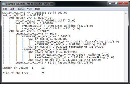

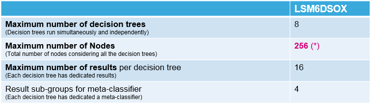

Hi @NGern , the HW limitations are the below depicted ones, so you shouldn't have exceeded them with your MLC configuration (N. of decision tree <8, few features, etc).
Is the decision trees you generated from your tool in the below format? Please note that the decision tree has been generated from a different tool, the format must be converted to the Weka J48 format (or to the RapidMiner format) in order to allow the Machine Learning Core tool in Unico to read the decision tree correctly (cfr AN5259, p.23) .

Thanks for the reply @Eleon BORLINI . Yes I did use Weka to generate the decision trees. I used the RandomForest model which generated 4 decision trees that were in the same format as the J48. An example of one of the trees from the RandomForest output is attached.
