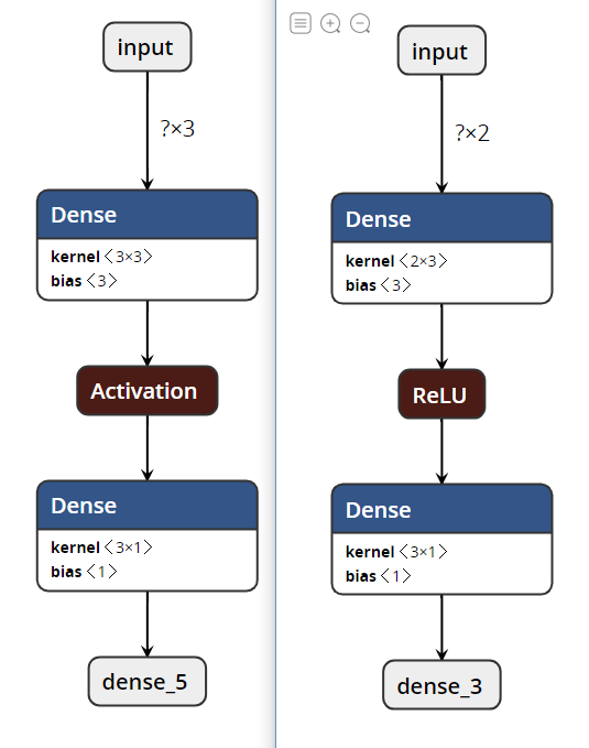

2019-04-01 6:51 AM
Here you can find a notebook I created to do such operation:
