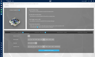

I can also suggest looking at the available data logger and the sensors in NanoEdge AI Studio, find something that suits you need, get the corresponding board and use the data logger code to create a project.
In the linked github, you will find the source code to read data of the selected sensor and send the data via serial: https://github.com/stm32-hotspot/stm32ai-nanoedge-datalogger/
Example:
STEVAL-STWINKT1B with ISM330DHCX accelerometer (source code on the github)

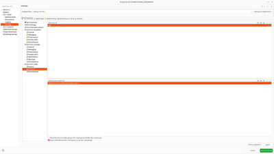

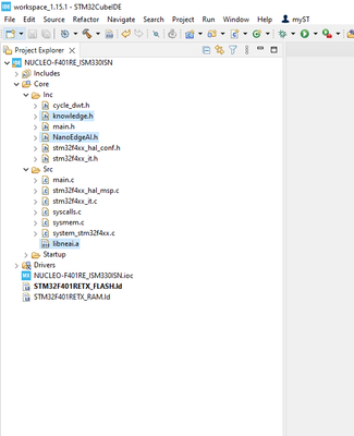

Open your STM32CubeIDE project and import knowledge.h, libneai.a and NanoEdgeAI.h. Generally, you want to had knowledge.h and NanoEdge.h in the Inc folder and the libneai.a in the src folder. Like this:
Make sure that the path to the libneai is set:

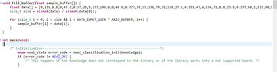

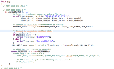

2024-07-22 1:29 AM
hello . thank you for your help.
is this code correct?
2024-07-22 3:09 AM
I believe that your rx_buffer contains the value that you want to use for the classification:
What does your rx_buffer look like?
sscanf("0,1,2,3,4,5,6,7", "%f,%f,%f,%f,%f,%f,%f,%f", &input_data[0],&input_data[1],&input_data[2],&input_data[3],&input_data[4],&input_data[5],&input_data[6],&input_data[7]);
sscanf("0 1 2 3 4 5 6 7", "%f %f %f %f %f %f %f %f", &input_data[0],&input_data[1],&input_data[2],&input_data[3],&input_data[4],&input_data[5],&input_data[6],&input_data[7]);
You can put the rx_buffer directly in the sscanf.
Then, you also have an issue with the classification. The result of the classification is not diabetes_status (it only returns a neai_state, look at my previous message). The result of the classification is id_class, so you need to have something like this:
if (&id_class == 0){
sprintf(result_msg, "Diabetes\r\n");
} else{
sprintf(result_msg, "Non-diabetes\r\n");

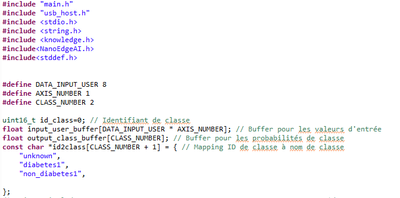

2024-07-23 2:25 AM
Hello, thank you very much for your support and help
i change my code like this :
this image for declaartion

and this is the main code in boucle while(1) :
and this exemple for my data :
I have 8 axes and each axis has 32 values in the line:
my biggest probleme now is how i put my data in the input_user_buffer and how i scan this input anf finnaly how in tera term i see is diabetes or non_diabetes

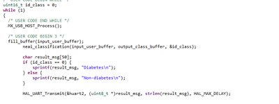

2024-07-23 6:34 AM
hello . i use this code
but always the same display whatever the data
2024-07-23 7:58 AM
I did make a mistake in my last message. The condition "&id_class == 0" is false. The id_class 0 correspond to unknown. the condition should test if the model is returning either 1 or 2 for the class Diabetes or Not diabetes:
if (&id_class == 1){
} else{
It should solve your issue.
