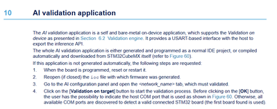

Where it shows this -
And I am wondering if such validation application already exists or I need to create one myself from the bottom up using your (Awesome) tutorial here that implements what you said -

Hello @pmiracle,
This is indeed a lot of redirecting :)
We are aware of this complexity, and we are slowly working on it.
Back to your issue:
My current effort is on checking the feasibility of using my model on the STM32N6 (In terms of performance) and I am not particularly looking into coding a firmware if this can be avoided.
Model zoo would have been more useful if you wanted to try retraining a model we propose on your dataset and test it live using the deployment script, that automatically modify the getting started.
In this case, I would suggest to just use the validation script.
The error you get is due to not using the validation firmware before running the command.
You need to go to your local installation folder of the ST Edge AI Core
For context, the ST Edge AI Core is the "model converter to C code" behind most ST AI Tools.
Then you need to go to /scripts/N6_scripts.
Then edit the config.json file, here is mine:
	"compiler_type": "gcc",
	// "gdb_server_path": "C:\\ST\\STM32CubeIDE_1.17.0\\STM32CubeIDE\\plugins\\com.st.stm32cube.ide.mcu.externaltools.stlink-gdb-server.win32_2.2.100.202501151542\\tools\\bin",
	// "gcc_binary_path": "C:\\ST\\STM32CubeIDE_1.17.0\\STM32CubeIDE\\plugins\\com.st.stm32cube.ide.mcu.externaltools.gnu-tools-for-stm32.13.3.rel1.win32_1.0.0.202411081344\\tools\\bin",
	"iar_binary_path": "C:\\Users\\foobar\\TOOLS\\IAR\\IAR9.30.1\\common\\bin\\",
	"objcopy_binary_path": "C:\\ST\\STM32CubeIDE_1.18.1\\STM32CubeIDE\\plugins\\com.st.stm32cube.ide.mcu.externaltools.gnu-tools-for-stm32.13.3.rel1.win32_1.0.0.202411081344\\tools\\bin\\arm-none-eabi-objcopy.exe",
	// "cubeProgrammerCLI_binary_path": "C:\\Program Files\\STMicroelectronics\\STM32Cube\\STM32CubeProgrammer\\bin\\STM32_Programmer_CLI.exe",
	"cubeide_path":"C:\\ST\\STM32CubeIDE_1.18.1\\STM32CubeIDE"
	// "make_binary_path":"C:\\ST\\STM32CubeIDE_1.17.0\\STM32CubeIDE\\plugins\\com.st.stm32cube.ide.mcu.externaltools.make.win32_2.2.0.202409170845\\tools\\bin\\make.exe"
I think that only the compiler type and cubeide_path are needed.
I don't remember what is by default in this folder, but the next step is to copy your model here, open a CLI and do a generate command: stedgeai.exe generate --model my_model --target stm32n6 --st-neural-art
Then you can run the python script n6_loader.py with your board plugged in dev mode. This will flash the validation firmware with your model.
Finally run the validate command.
