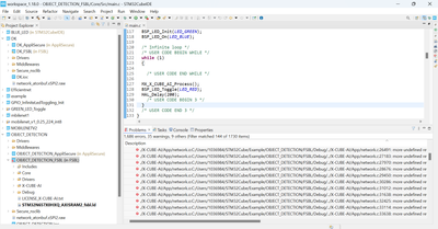

By referring the document shared and creating the project file I got some issues in the NUCLEO side.
The document actually refers to creating the project file for the DK board not actualy the Nucleo board which is my need. while creating the project file and building the code i got these much amount of errors.

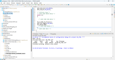

I also tried creating the project file for DK board and Building it while doing the same i got no errros while building the code.
Can you check with this and get back ASAP.
Thanks and Regards,
Vinay
2025-07-04 1:49 AM
Hello @VinaySankar,
If there are any depencies errors such as outside sources not being correctly found, you can add then manually inside the nested projects.
For example, if you have errors saying that LL functions are undeclared, it means that the compiler is not being able to find the LL sources that are in the global Middlewares folder.
You should then import only the sources and be sure to set the imported folder as a source location in the general settings.
To import a folder, you right click on the project, then hit "Import", then "General", then "File system". You select the folder whose sources are not being found and filter to import only the .c. Afterwards, you right click on the project again and go in "Properties", then "C/C++ General", then "Paths and Symbols" and under the "Source Location" section you add the folder you’ve just imported.
