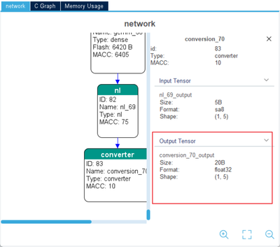

By annalyze it ,the output should be float as below

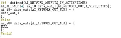

But the auto generated code declare it as ai_i8,why?

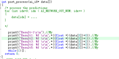

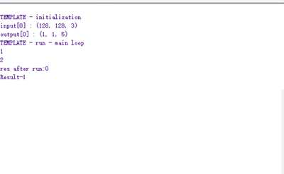

and I can`t get result in the following way,I don`t konw the reason

Hello @123456dad ,
this is due to the quantization of the model as explained in the UM2526 section 1.3:
so to improve CPU and hardware accelerator latency this conversion from float to the ai_i8 is needed.
Hope this answers your request .
