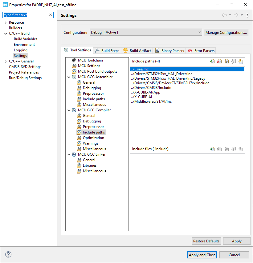

How to deal with fatal error: ai_platform.h: No such file or directory? I can't find this file anywhere in the project.

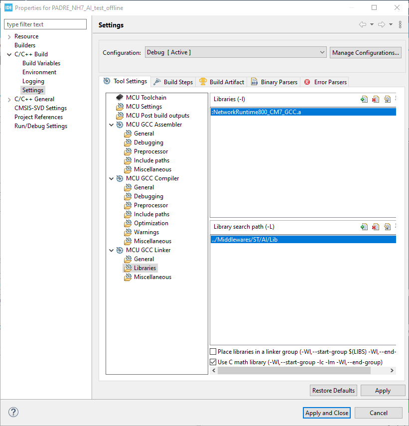

I tried using different versions of CubeIDE and X-CUBE-AI, added include paths in project properties. I checked on F7 and H7. I have Core and ApplicationTemplate selected in Software Packs Component Selector.

Middlewares folder is not generated in the project, I do not know why.
After copying this folder from another project, the problem with ai_platform.h disappeared.
