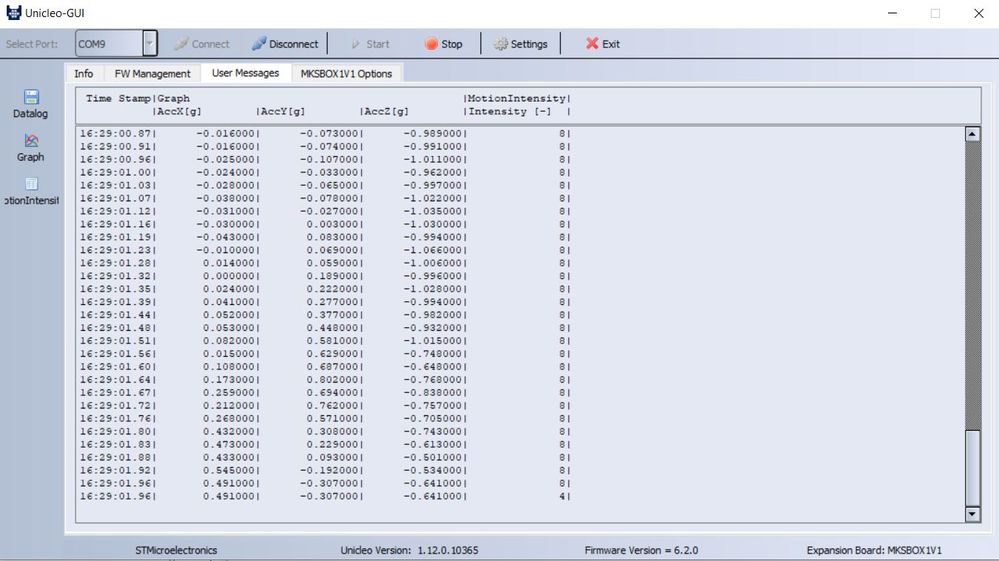

I bought the sensor box and tried to reproduce the example in the recent webinar. I believe I followed all of the steps exactly and got similar results with two exceptions. One is my stationary intensity value starts at 8 and drops to 4 when I start mov
KWine
Senior
ing the sensor box. But as soon as the intensity value changes the graph and data collection freeze. In fact, I noticed before I finished the example and was just plotting the three accel values that the graph would freeze occasionally, but never reproducibly. Is this a bad USB cable, MCU crashing, LSM6DSO)X crashing? Any idea why I can;t get the simple webinar example to work robustly?0693W000001pVXRQA2.jpg

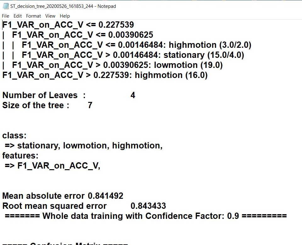

I am wondering if the graphics problem has somehow corrupted my data (or maybe I didn;t capture the data properly) since the decision tree looks odd to me. I don;t quite know if I am interpreting it correctly, but it looks like the high motion branch is both below and above the other two?0693W000001pVZrQAM.jpg
