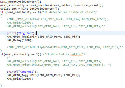

I'm trying to figure out how the 1_class library works. In the Emulator tab of the NanoedgeAI Studio software, I can see that the sensor indicates that the input pattern is detected as an outlier (outside the class considered), as shown in the following image:
But when embedded on microcontrollers, according to my code the orange LED should be flashing, but it's the green LED. I can't figure it out. Is my code correct? How can I retrieve the function output, which should be 0 for belongs to the class or 1 for outside of the class?
Thanks for your help.
A part of my code :
/*________________1_class_____________________*/
neai_state = neai_oneclass_init(knowledge);
/* Infinite loop */
/* USER CODE BEGIN WHILE */
while (1)
if (drdy) {
/* Reset data ready variable */
drdy = 0;
/* Read watermark flag */
iis3dwb_fifo_status_get(&dev_ctx, &fifo_status);
if (fifo_status.fifo_th) {
num = fifo_status.fifo_level;
if (data_left > num) {
data_left -= num;
else {
num = data_left;
data_left = 0;
iis3dwb_get_buffer_from_fifo(num);
if (data_left == 0) {
/* Stop FIFO mode, set it in BYPASS mode */
iis3dwb_fifo_mode_set(&dev_ctx, IIS3DWB_BYPASS_MODE);
#if NEAI_MODE
uint32_t cycles_cnt = 0;
/* ############################## Partie Mode 1-class #######################################################*/
/*ici*/
KIN1_ResetCycleCounter();
neai_similarity = neai_oneclass(neai_buffer, &oneclass_result);
cycles_cnt = KIN1_GetCycleCounter();
if (neai_similarity == 0)
/*HAL_GPIO_WritePin(LED1_GPIO_Port, LED1_Pin, GPIO_PIN_RESET);
HAL_Delay(1000);
HAL_GPIO_WritePin(LED2_GPIO_Port, LED2_Pin, GPIO_PIN_SET);*/
printf("Regular");
HAL_GPIO_TogglePin(LED1_GPIO_Port, LED1_Pin);
HAL_Delay(1000);
/*HAL_GPIO_WriteMultipleStatePin(LED1_GPIO_Port, LED1_Pin, LED2_Pin);*/
if(neai_similarity == 1){
HAL_GPIO_WritePin(LED1_GPIO_Port, LED1_Pin, GPIO_PIN_SET);
HAL_GPIO_WritePin(LED2_GPIO_Port, LED2_Pin, GPIO_PIN_RESET); */
printf("Abnormal");
HAL_GPIO_TogglePin(LED2_GPIO_Port, LED2_Pin);
HAL_Delay(1000);
neai_time = (cycles_cnt * 1000000.0) / HAL_RCC_GetSysClockFreq();
printf("\n");
printf("NEAI learn return: %d.\n", neai_similarity);

In your if conditions, you should replace neai_similarity by oneclass_result, to make the orange LED blink when an outlier is detected.
You should also rename the neai_similarity variable by neai_state. Similarity has no meaning in 1-class classification.

In your code, the result of the outlier detection is stored in oneclass_result. NanoEdgeAI functions return a status variable.
For more details, please check the documentation:
https://wiki.st.com/stm32mcu/wiki/AI:NanoEdge_AI_Library_for_1-class_classification_(1CC)

Thanks for your quick reply. I already check the documentation that your are mentioned. My preoccupation is that concerning the below code, the orange LED (LED2) should blink instead of the green LED (LED1).

Wonderful!! it's works!!!
