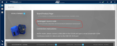

2023-11-06 11:50 PM
I am a beginner
I downloaded the STM32-NANOEDGE-DATALOGGER firmware via the github link.
This STM32-NANOEDGE-DATALOGGER is used in NaoedgeAIStudio and is streaming data via UART (VCOM port) from STLink.
but I see that the example is only given for an AD (Anomaly Detection) project and I'd like to know how to modify it for an n-Class project?
Also, is it possible to add the USB_CDC_ACM class to activate the VCOM port on the STWIN.box without the STLink?
If so, how do I do it?
Board used: STWIN.box

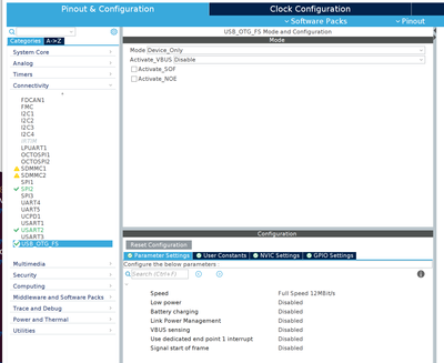

Concerning the USB CDC:
First, you need to configure USB_OTG_FS in Device_Only, see below:
Then look at the code attached to add it in your project.
Best regards,
Julian

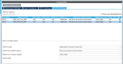

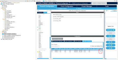

2023-11-14 12:05 AM
Hello @Julian E. , thank you again for your reply
So I opened the .ioc of my project to complete with USB_OTG_FS as shown on the image. But I can't check the following boxes. Is it normal?
Then i generated le C code i realized that there is no file name "usb_device.h" like identified in the file attached in your message.
So are you open the same project from this link on image below ? or a new project?
Thanks for your help!
Best Regards

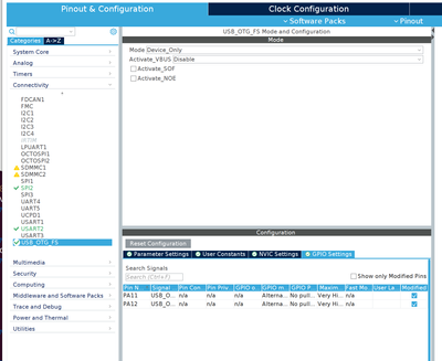

2023-11-14 12:54 AM
First, yes, it is normal that you cannot check the following boxes. You can click on PA11 and PA12 and change the Maximum output speed to very high:
Then for the usb_device.h, please go to https://github.com/STMicroelectronics/stm32_mw_usb_device and get:
Then add them to your drivers.
Best regards,
Julian

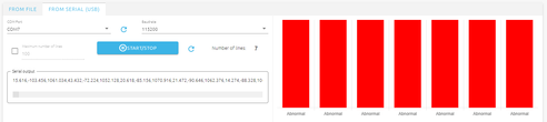

2023-11-23 12:29 AM
Hello @Julian E. ,
Thanks for your help, but it's very difficult for me!!! so I've abandoned the project to add the USB_CDC_ACM class to activate the VCOM port on the STWIN.box.
Now I'm trying to figure out how the 1_class library works. In the Emulator tab of the NanoedgeAI Studio software, I can see that the sensor indicates that the input pattern is detected as an outlier (outside the class considered), as shown in the following image:
But when embedded on microcontrollers, according to my code the orange LED should be flashing, but it's the green LED. I can't figure it out. Is my code correct? How can I retrieve the function output, which should be 0 for belongs to the class or 1 for outside of the class?
Thanks for your help.
