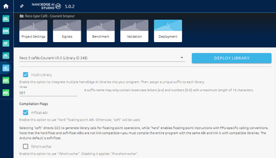

In the last step of NanoEdge AI Studio, the compilation, you can select the Multi-library option.
You need to enter a name to your library that will be used as a suffix for the files to include in your project and in the function names, for you to freely use each library.
For example, here is a classification project, where I call my library lib1:
