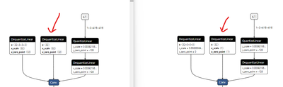

Additionally, you can check it in neutron for example:
For exemple:
On the left is PerChannel, on the right is PerTensor
