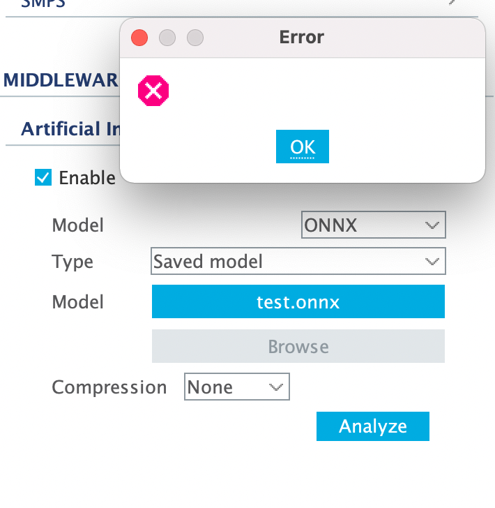

Hi, Thanks for your attention. I am analyzing the .onnx format model but an error occurs. I try to reinstall the stm32cubeMX but it doesn't help.

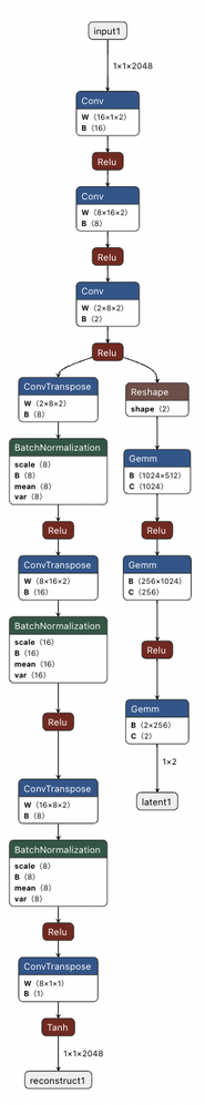

The part of architecture is:
Here is the log information. Can you help me with this problem? @Romain LE DONGE @jean-michel.d @fauvarque.daniel Thanks very much!

2022-07-08 15:40:11,500 [INFO] CmdLine:100 - Command: /Users/name/STM32Cube/Repository//Packs/STMicroelectronics/X-CUBE-AI/7.2.0/Utilities/mac/stm32ai analyze --name network -m /Users/name/STM32Cube/test.onnx --type onnx --compression none --verbosity 1 --workspace /var/folders/y8/7c4vvzbj2l1dw7trnz05b52m0000gn/T/mxAI_workspace5038345178307913369027895421033696 --output /Users/name/.stm32cubemx/network_output --allocate-outputs
2022-07-08 15:40:12,022 [INFO] CmdLine:132 - stm32ai exit with status: 132
2022-07-08 15:40:12,025 [ERROR] CmdLine:135 - stm32ai return with an error

I have checked that all the layers in my .onnx model are supported.
Please refer to ..../STM32Cube/Repository/Packs/STMicroelectronics/X-CUBE-AI/7.2.0/Documentation/supported_ops_onnx.html

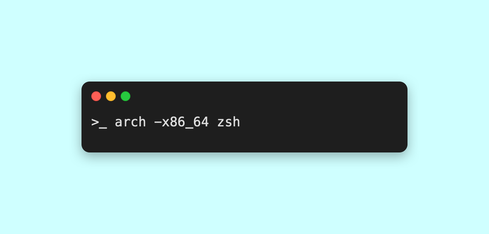

Can you try enabling manually Apple's Rosetta 2 compatibility layer using the solution from this thread: https://github.com/nvm-sh/nvm/issues/2350#issuecomment-734132550
Then try running again the stm32ai command line call

Thanks for your quick and kind reply. I try it but fail.
That is sad news. Maybe we need a new build one for M1 specifically or use windows instead.
