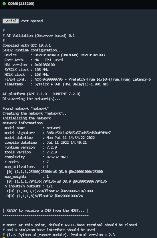

I'm trying to send data and retrieve the output from my stm32f4-DISCO. I'm using a python based code and specifically stm_ai_runner. The code is rather simpler but I can't access the board because even runner.summary() doesn't work. My board is flashed with the network :
And this is what my code looks like :
And the terminal :

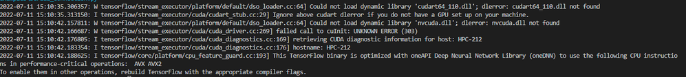

the tensorflow messages that you are seeing are because you don't have a NVIDIA graphics card on your machine. To get rid of those messages you can perform:
pip install tensorflow-cpu==2.9.0
of course the version of tensorflow-cpu must correspond to the version of tensorflow you have on the machine.
Also Tensorflow requires AVX2 enabled CPU, if you have an old machine with AVX2 not supported, tensorflow won't work

I do not think that the problem come from the warnings, but I did as you asked and install tensorflow-cpu and my CPU is AVX2 enabled.

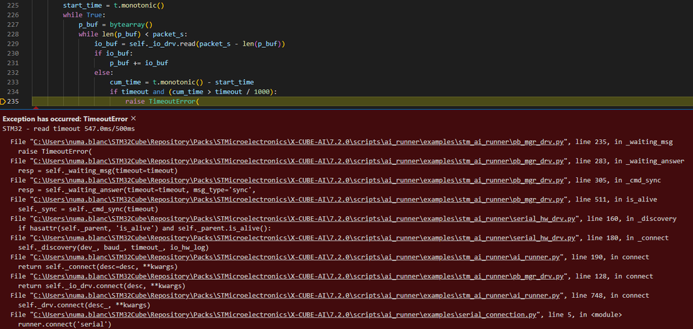

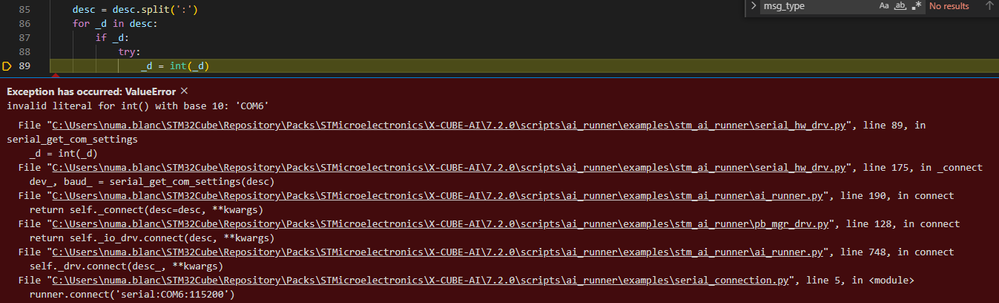

There is some news, I changed my keras model into a tflite model and visibly He now tries to connect. When I do what you said about specify explicitly the COM port like so :
runner = AiRunner()
runner.connect('serial:COM6:115200')
runner.summary() # display the network/run-time information
inputs = tf.fill([1,96,96,1], 0)
outputs, _ = runner.invoke(inputs) # invoke the modelI get this error message :
And when I try to just put :
if runner.connect('serial'):I get this error :
So it seems to try to connect but doesn't seem to success...
Even when I change the port- default value in "serial_hw_drv.py" like so :
# default values
port_ = 'COM6'
baud_ = int(115200)I get the same error, do you know why ?

2022-07-12 2:12 AM
Hi @NBlan.1
Are you using the latest AIRunner version associated with X-Cube-AI 7.2.0 ?
The Python and C code are linked together (stm32ai CLI, C code, and AIRunner should be aligned). One side will wait for specific messages from the other side and if messages are not aligned then the communication will not be possible.
Then I would suggest you to unplug all COM ports devices from your computer (even disabling the Intel default one if you're on Windows laptop), then try also killing all instances of Python you can have in the Task Manager (if instances are still using COM port then the communication will fail) and try again the procedure.
If the problem is still here, you can try rebooting your computer knowing that Windows can have strange behavior with COM ports pluging/unpluging multiple times
