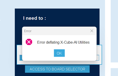

Hii!
I'm trying to implement a tensorflow ML model in NUCLEOF401RE Board using XCube.AI and stm32CubeMX. when i download the XCube.AI package and try to add the zipper file in CubeMX im facing an error that "file cannot be deflated". how to solve this error. The zipper file is installed in proper location ""C:\Users\Lakshana\STM32Cube\Repository\Packs\STMicroelectronics\X-CUBE-AI\8.1.0\stm32ai-windows-8.1.0.zip" please help me resolve this error

Can you please verify the zip size ? Are you able to open it with tools like 7-Zip ?
X-CUBE-AI and Utilities should be downloaded from STM32CubeMX. If you experience issues, you can install it offline from X-CUBE-AI - AI expansion pack for STM32CubeMX - STMicroelectronics
- Download the .pack
- Download the tool based on your platform
Best regards,
Yanis
