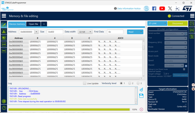

Thanks very much!I have tried the model zoo -3.1.0 ,but there is the same error. My os is Win11.When I open STM32CubeProgrammer and plug the ST through its ST Link, when I click connect, it works(I’m actually using a USB Type-C cable, but it’s being recognized as an ST-LINK).

Hello!I tried to use c-c cable,and it's okay now.But the output says:
Erasing memory corresponding to segment 0:
Erasing external memory sector 0
Error: failed to erase memory
Board programming failed: "Error: failed to erase memory"That's why? I found there is a solution,but is there a solution for automatic way?Thanks!

Hello @wyb217 ,
In your last message, it is the output of STM32CubeProgrammer right? What did you try to do?
Anyways, the goal of checking to see if you could connect via stm32cubeProgrammer was just to check if the board was functioning well or if you had an issue even doing something as simple as connecting.
I tried to run your exact yaml and I had no issues. I could not reproduce your error.
I saw in another thread a user solving your issue, you may want to try his solution:
Solved: Re: ST-LINK error (DEV_CONNECT_ERR) - STMicroelectronics Community
Make sure to put both pins to the right when flashing the code.
Then, once flashed, put both pins to the left and unplug/plug again the board.
Have a good day,
