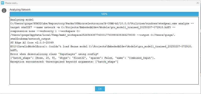

I have useed TensorFlow Version 2.18.0 and keras version 3.8.0 to design and train GRU Model. The GRU model was analysed with X-Cube-AI 10.0.0. The error results are in the picture above.
Please help me sort the problem. Thanks.

The issue has been sorted out by using the model in .tflite format. I do not know yet why do the .h5 & .hdf5 format have the issue.

Your input size for the original model is [None,20,9], sometimes it creates errors.
