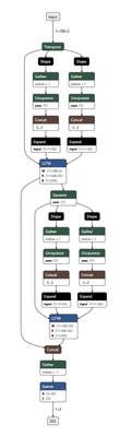

As stated, I have problem analyzing the ONNX model ported from a pytorch model. The code of the model is simple as follows:
class LSTM(nn.Module):
def __init__(self, input_size, hidden_size, num_layers, num_output=1):
super(LSTM, self).__init__()
self.num_layers = num_layers
self.input_size = input_size
self.hidden_size = hidden_size
self.num_output = num_output
self.lstm = nn.LSTM(input_size=input_size, hidden_size=hidden_size,
num_layers=num_layers, batch_first=True)
self.fc = nn.Linear(hidden_size, num_output)
def forward(self, x, device='cuda'):
ula, (h_out, _) = self.lstm(x)
out = self.fc(h_out[-1])
return out
Netron vis:
I will really appreciate any advice or workarounds. Thank you!
2024-12-16 5:26 AM
Hi everyone,
I did some test on my side and we currently only support LSTM with 1 hidden size and 1 layer. Something like:
import torch
import torch.nn as nn
# Simple lstm that works
num_layers=num_layers, batch_first=True, bidirectional=False)
return out
# If not 1 : error
# other parameter we can put anything
input_size = 10
hidden_size = 1
num_layers = 1
num_output = 10
model = LSTM(input_size, hidden_size, num_layers, num_output)
model.eval()
dummy_input = torch.randn(1, 128, input_size)
onnx_file_path = "simple_lstml.onnx"
torch.onnx.export(model, dummy_input, onnx_file_path,
input_names=['input'], output_names=['output'])
I tried to stack multiple LSTM but I had no success.
I am asking for more information, I will keep you updated
Have a good day,
Julian

2024-12-16 12:55 AM
No not yet, I hope ST staffs will check my model and give us further guidance.
2024-12-16 1:28 AM
I read a answer. someone answer cubeai 10.0.0version slolve this question. but I not try yet.
2024-12-16 1:49 AM
I tried the X-Cube-AI 10.0.0 and also the new ST Edge AI Developer Cloud, they did not solve my problem.

2024-12-16 7:35 AM
Thank you! I have tried the one-layer case and it succeeded. Please keep sharing further information on multi-layer case if any :)

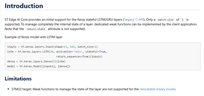

2024-12-16 8:32 AM
Hello @Lemanoise ,
Using tensorflow, I could use multiple LSTM one after the other (which I did not succeed to do with pytorch).
It may be useful for you:
import tensorflow as tf
from tensorflow.keras.models import Model
from tensorflow.keras.layers import Input, LSTM, Dense
input_layer = Input(shape=(100, 2), batch_size=1)
lstm1= LSTM(32, activation='relu', stateful=True,return_sequences=True)(input_layer)
lstm2 = LSTM(32, activation='relu', stateful=True,return_sequences=True)(lstm1)
output_layer = Dense(units=3, activation='linear')(lstm2)
# Create the model
model = Model(inputs=input_layer, outputs=output_layer)
# Print the model summary
model.summary()
# Compile the model
model.compile(optimizer='adam', loss='mean_squared_error')
model.save('tf_lstm.h5')
Be careful to follow these instructions while using it:
https://stedgeai-dc.st.com/assets/embedded-docs/keras_lstm_stateful.html
Have a good day,
Julian
