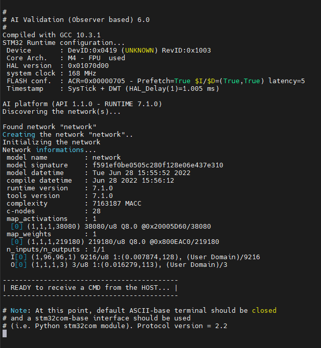

2022-06-28 6:48 AM
If you see the message at reset then the validation on target should work.
Tell the validation on target the COM port you where using with MobaXterm and make sure you close MobaXterm before to launch the validation on target (on windows you can have only one process accessing a COM port)

Even by using the same COM port "validate on target" doesn't work (same errors as before) but MobaXtermn telling me that there is no problem :Do you know the origin of the problem ? IS this the X-Cube-AI version that is too recent ?
