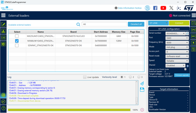

I am working with the STM32N6570-DK board and running the STM32N6-GettingStarted-ObjectDetection example. When I debug the program in CubeIDE (The MCU runs in Dev mode), I encounter the following issue:
In the main loop, when the function LL_ATON_RT_RunEpochBlock is called, the debugger reports:
Target is not responding, retrying...At this point, pressing the NRST button on the board does not reset the MCU.
The only way to recover is to power cycle the board.
Any suggestions would be greatly appreciated.

Hello @yangweidage,
I do not reproduce the issue.
I did try with the version 2.1.1 of the package that came out 5 days ago. Maybe explaining the difference.
I just:
I have no issue stepping over it.
Could you confirm that it is what you did and detail the versions of the tool you are using please?
Have a good day,
Julian
