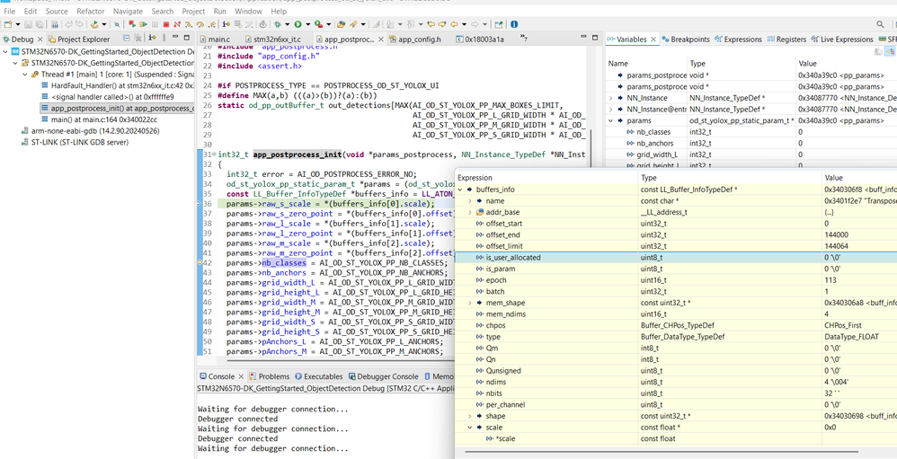

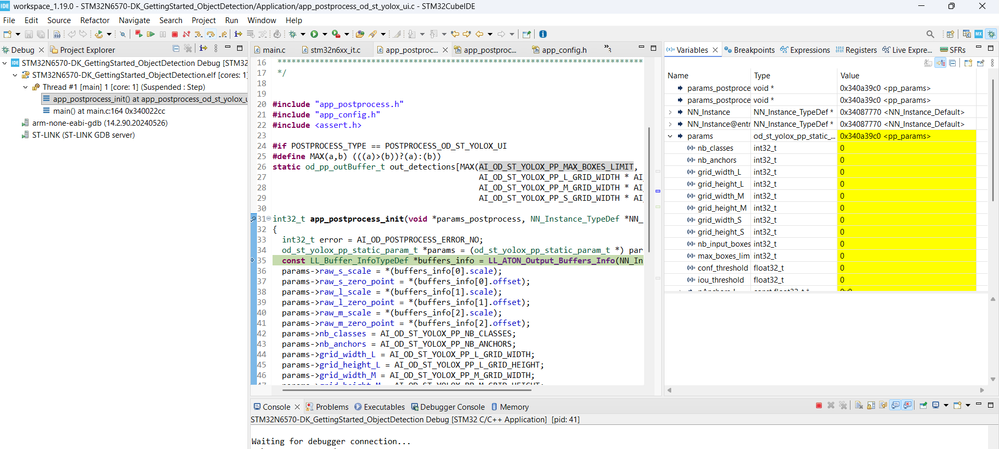

But i have this error at this step : app_postprocess_init
The parameters
Do you have en idea how i can resolve this ?

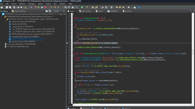

Downloaded the model in the card and launch the debug
Now stuck in Run Inference
A question ? does the model need to be quantized in input in UINT8 or it could be INT8 ?

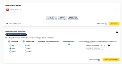

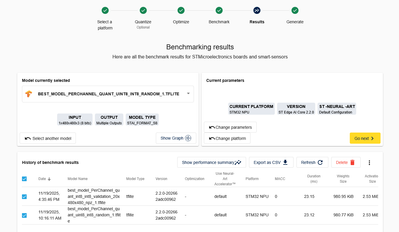

That i did today is to quantize my model (h5 file) with ST Edge AI Developer Cloud.
All the process is ok
