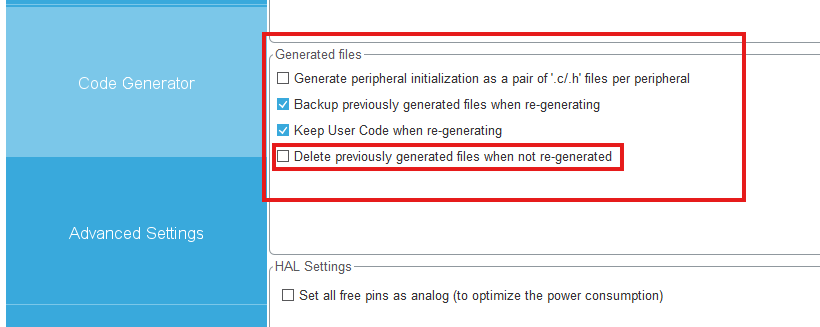

When regenerating using STM32CubeMX, please verify these settings:
Best regards

@hamitiya As suggested by you, I started the project in AI studio from scratch and generated the IDE project . I opened it in STM32 IDE and build the application code in it. It got built without any errors. Then I opened its Cube MX file to add the parameters I want for example ADC- I added it in application mode and took care of above settings in code generator . But after pressing generate code in its cube MX file, It still removed the AI headers from application and made changes automatically in studio AI files.
