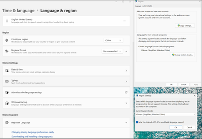

You can activate UTF-8 compatibility with the Chinese version of windows:
Go to Time & Language -> Language & Region -> Administrative language settings -> Change system locale -> and check Beta: Use UTF-8.
You may have to restart your pc for it to be applied.

This is indeed, as you mentioned, likely an encoding issue. Changing "gbk" to UTF-8 might solve the problem, but this would affect some of my documents and cause them to display as garbled text, so I cannot try this operation. Perhaps I could try it in a virtual machine.

Hello, I changed the GBK encoding to UTF-8 encoding in the virtual machine, which solved the problem. This is an effective method. Thank you for your help. Additionally, the new interface can display more content, which is helpful for my paper. However, the program often crashes in the virtual machine. I hope this encoding anomaly issue can be fixed as soon as possible.Thank you.

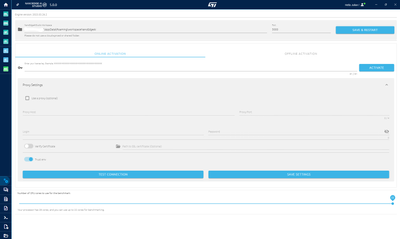

What you can maybe try to reduce the crashes in your virtual machine is to go to the settings in NanoEdge AI Studio and at the bottom, reduce the number of CPU cores used during the benchmark. It will let the VM uses more cores for the rest, maybe reducing the risk of crash.
