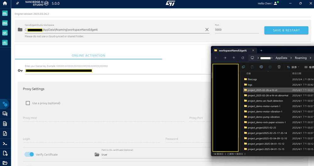

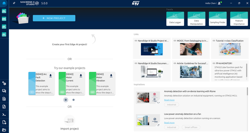

2025-04-01 1:06 AM
Hi Julian,
Attached are two screenshots of the path settings and the home screen for your reference, in case they help identify the issue.

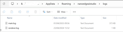

Can you also send me these logs please:
Thank you
Julian

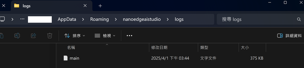

2025-04-01 1:14 AM
2025-04-01 1:20 AM
Hi Julian,
In my project folder, there is only the 'main' file.
2025-04-01 6:01 AM - edited 2025-04-01 6:02 AM
Hello @winmanchen,
Yes, it is this file that we need.

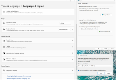

After investigation, there is a bug due a character that is not the same in UTF-8 and GBK (these are encodings).
We found a fix that should correct all your issues (described for the Intel i9 12900 CPU, for the other one, you first need to follow what I described in my previous message)
You can activate UTF-8 compatibility with the Chinese version of windows:
Go to Time & Language -> Language & Region -> Administrative language settings -> Change system locale -> and check Beta: Use UTF-8.
Let me know if it worked.
