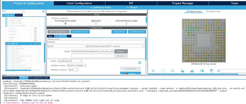

I'm trying to test a model on the STM32N6 but stedgeai tool fails to analyse the model:
ST Edge AI Core v2.0.0-20049
TOOL ERROR: list index out of range
I'm using X-CUBE-AI 10.0.0, STM32CubeN6 v1.1.0 and STM32CubeIDE 1.18.0.
The model I'm trying to use is in attachment.
I've also tried with STM32Cube.AI MCU Runtime mode but the error is the same.
How can I fix the issue ?

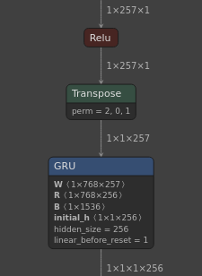

For sure, the GRUs layers are the cause of the error but it is a stedgeai core bug.
GRUs and LSTMs are badly supported as of today.

But I see that the previous Transpose node seems to be misinterpreted:
Computing all activation shapes of node_32 (Transpose)
In shapes [(BATCH: 1, CH: 257, H: 1)] - In values shape [None]
Resetting shape of node_32
Computing remapping starting from (2, 0, 1)
Computed remapping is
BATCH <- H
CH <- BATCH
H <- CH
BATCH <- H
CH <- BATCH
H <- CH
Found new output shapes: [(BATCH: 1, CH: 257, H: 1)]The output shape should be [1, 1, 257] instead of [1, 257, 1]:
But the error is the same at the GRU node. Maybe it expects the same dimensions for weights as a LSTM (which expect [num_directions, 4*hidden_size, input_size] for weights), but GRU needs 3*hidden_size instead of 4.
There is an alternative model using LSTM instead here: https://github.com/GreenWaves-Technologies/tiny_denoiser_v2/blob/public/model/denoiser_LSTM_Valetini.onnx
I got farther but I still get blocked at some point.
The Transpose adjustment is definitely needed to get further.
