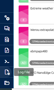

Hello @hashimoto_m,
try to close every app that may use the COM port and retry.
Can you share the logs please?
You can find them here:
Julian
