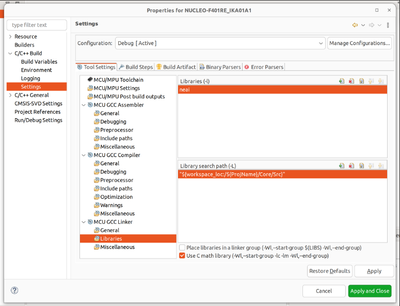

Please replace libneai.a to neai:
This should work.

Hello @hashimoto_m,
NanoEdge libraries are easy to add your embedded project. You need to:

I placed libneai.a generated by [COMPILELIBRARY] of [Deployment] of [NANOEDG EAI STUDIO]
in the core/src folder and linked libneai.a. (See attached image)
However, when I built it, the following error occurred.
I wonder if the link setting is wrong.
10:15:46 **** Incremental Build of configuration Debug for project HTS221_Sample_Deployment **** make -j8 all arm-none-eabi-gcc -o "HTS221_Sample_Deployment.elf" @"objects.list" -llibneai.a -mcpu=cortex-m4 -T"C:\ST\workspace2\HTS221_Sample_Deployment\STM32L475VGTX_FLASH.ld" --specs=nosys.specs -Wl,-Map ="HTS221_Sample_Deployment.map" -Wl,--gc-sections -static -L"C:\ST\workspace2\HTS221_Sample_Deployment\Core\Src" --specs=nano.specs -mfpu=fpv4-sp-d16 -mfloat-abi=hard -mthumb -Wl,--start-group -lc -lm -Wl,--end-group C:/ST/STM32CubeIDE_1.16.1/STM32CubeIDE/plugins/com.st.stm32cube.ide.mcu.externaltools.gnu-tools-for-stm32 .12.3.rel1.win32_1.0.200.202406191623/tools/bin/../lib/gcc/arm-none-eabi/12.3.1/../../../../arm-none-eabi/ bin/ld.exe: cannot find -llibneai.a: No such file or directory collect2.exe: error: ld returned 1 exit status make: *** [makefile:69: HTS221_Sample_Deployment.elf] Error 1 "make -j8 all" terminated with exit code 2. Build might be incomplete. 10:15:46 Build Failed. 2 errors, 0 warnings. (took 659ms)

Hello @hashimoto_m,
This should work.

Hello Julian
Thank you for your reply.
It worked, thank you.
