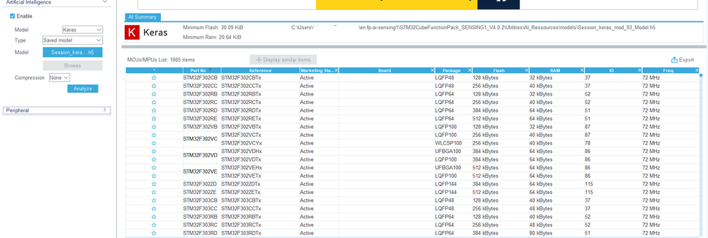

Hi @ShivaRagu ,
Let me share with you my comprehension to avoid any misunderstanding: so, you have downloaded FP-AI-SENSING1 pack and you browse the Session_keras_mod_93_Model.h5 keras model after enabling the Artificial Intelligence search criteria in the MCU selector tab. Did I correctly reproduce your scenario?
Actually, following the steps above, no error window is displayed and the file is analyzed without any problem:
Could you please precise which CubeMX version are you using ?
Also, you can attach your log files under: <USER_HOME>\.stm32cubemx\STM32CubeMX.log and <USER_HOME>\.stmcufinder\STMCUFinder.log. They may revel the root cause of this misbehavior.
