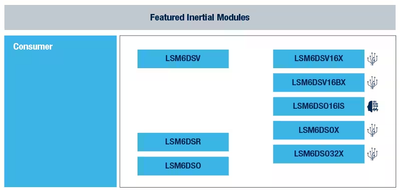

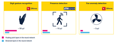

Can another sensor recognize these gestures that would be better for my application?
Maybe the LSM6DSO16IS with its ISPU - intelligent sensor processing unit?
It is mentioned that it can even do digital gesture recognition.

Hi @Pointes ,
you can try to use the ISPU to get to better results, but the digit gesture recognition is linked to the Qvar, so you should add a sensor embedding the Qvar.
anyway, with the ISPU you have a lot a flexibility in developing your own neural network but you have to be an expert in C programming to be able to implement it.
automated tools to develop networks are not available now.
