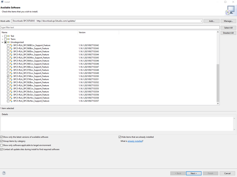

Hello CoolMo,
Update on SPC574K2 RLA has been pushed in http://download.spc5studio.com/updates
You can update only the following feature
SPC5-RLA_SPC574Kxx_Support_Feature 1.16.2
Sorry for the issue ;)

Hello CoolMo,
Best Regards
Erwan

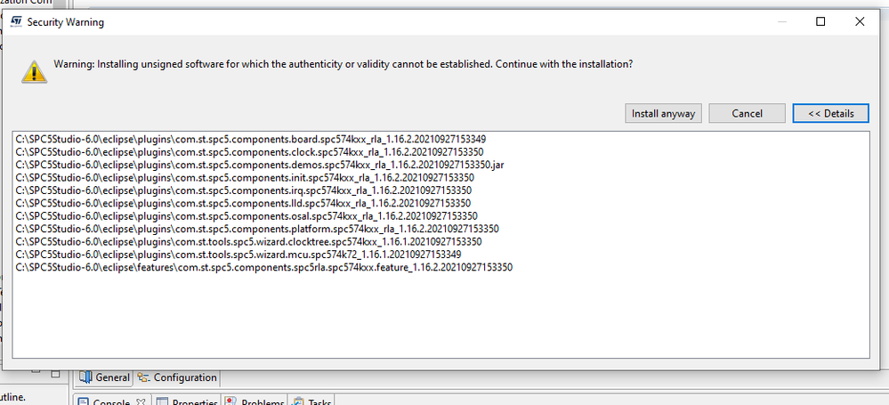

2021-10-15 4:28 AM
Yes, I can confirm the examples now work with 1.16.2.
Thank you for prompt and quick acting.
one last thing: signing of plugin may need to be included for next releases (install anyway is possible and things work afterwards):
Thanks again
Mo
2021-10-15 5:36 AM
Hello CoolMo ,
We need to create a real signature in our next delivery workbench. (features & plugins)
you can click on "Install Anyway"
it is a change request in our process ;)
