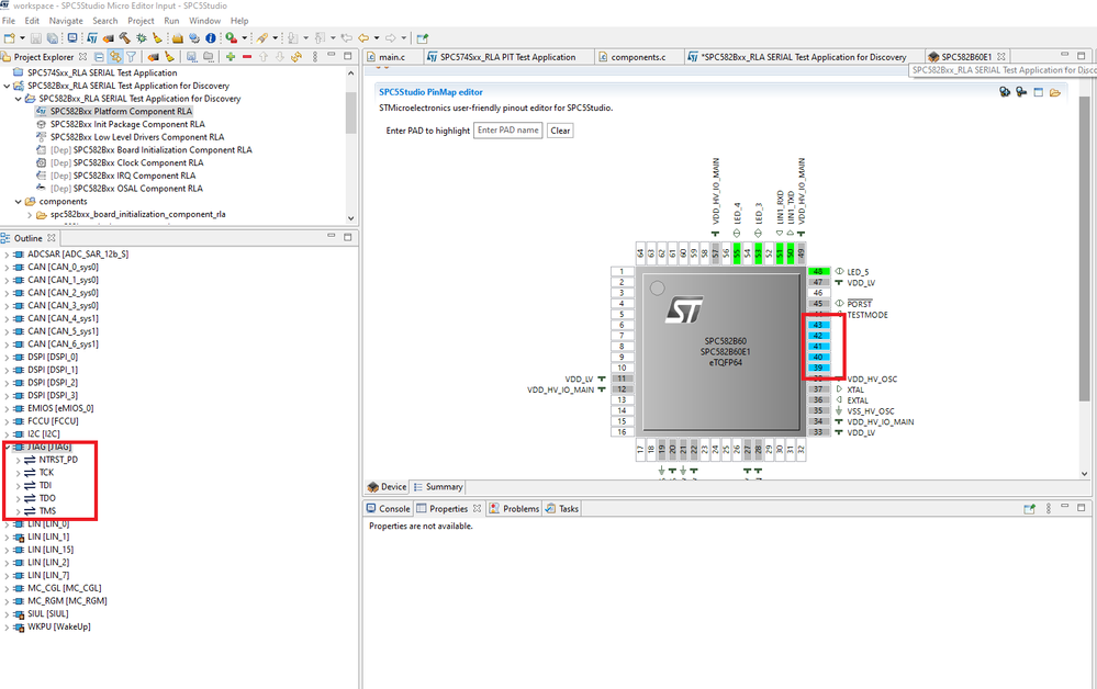

Using SPC582B chip with only 64 pins, will it be possible to use JTAG to send traces ?
CCOLL.2
Associate II
Using SPC582B chip with only 64 pins, the nexus interface pins will not be available.
Does this mean that there are no trace possibilities ?

Hi Erwan,
Thanks for your answer.
In fact, I'm not aware of the JTAG feature. So, to precise my question, as we do not have Nexus pins available, will it be possible to have traces and to do code coverage and profiling with only JTAG pins?
Rgds,
Christophe
CCOLL.2
Associate II
To complete my question, on 64 pins chip, I agree that we have access to JTAG pins but we don't have access to the Nexus auxiliary port pins.
I understand that there is the SPU HW bloc which goal is to give an interface between JTAG pins and some Nexus HW blocs inside the chip. But we cannot use all the debug features.
So, if I use the 64 pins chip and a probe like PLS UAD2Pro, can I use Nexus traces in order to do SW code coverage and code profiling ?
