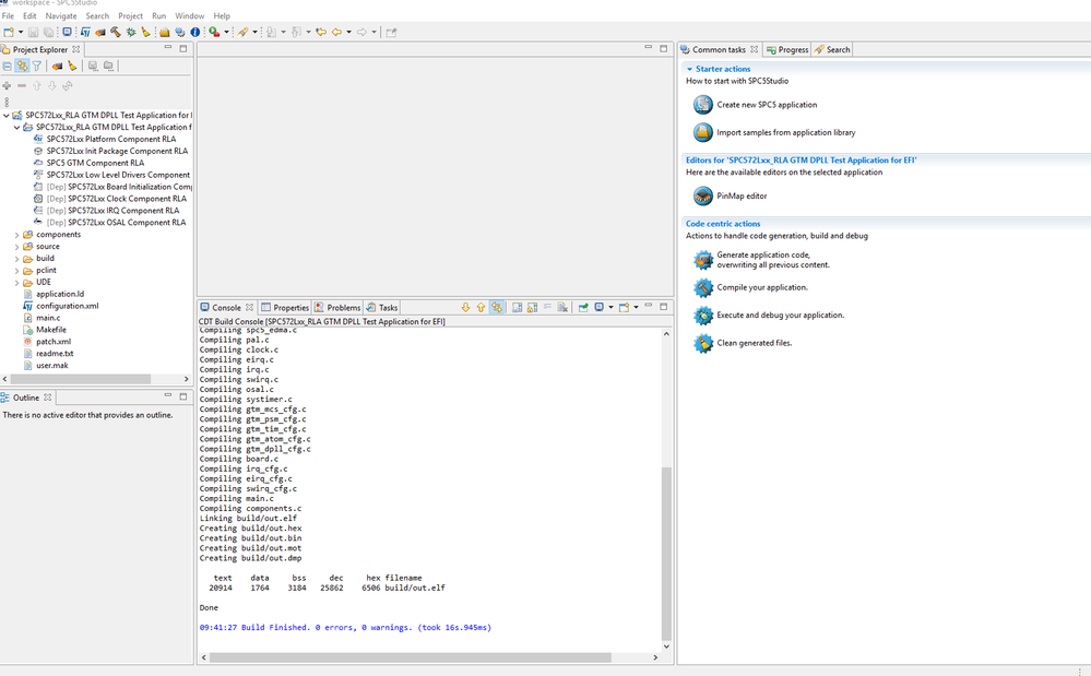

Thank you. That gets rid of the error for components.h but I still have the "#include <build/mcs/mcs0.h>" error. I don't have a build folder or an mcs0.h file in the project directory, do I need that line? I do have mcs0.mcs in the source folder.

19:27:14 Build Finished. 0 errors, 0 warnings. (took 327ms)
Although it states no errors I don't see any hex or elf files.

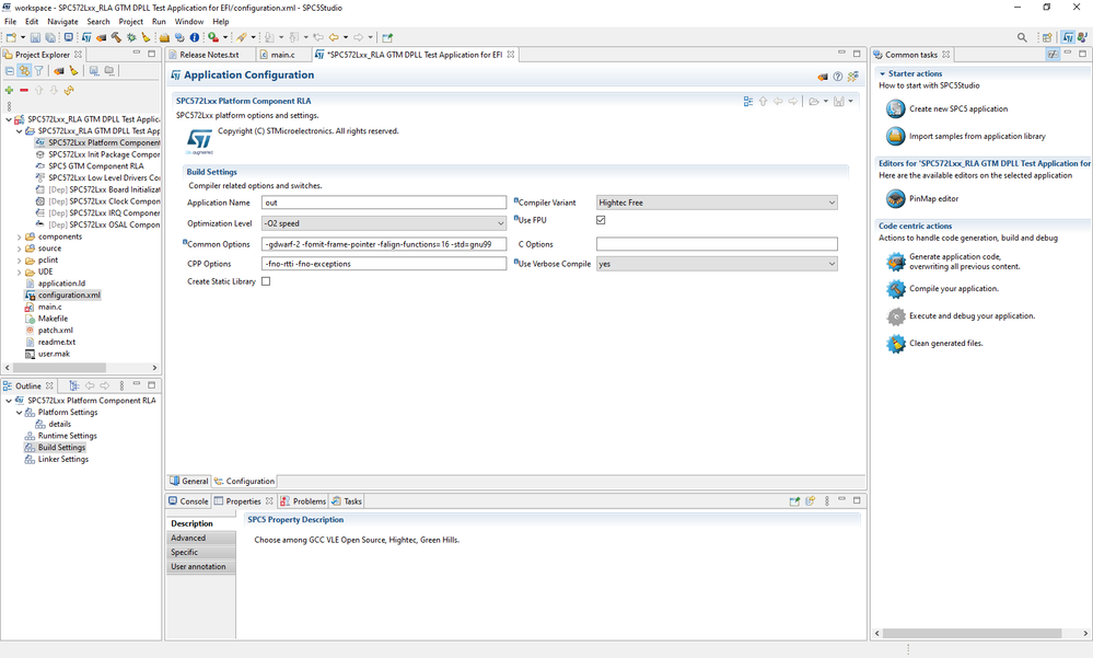

I have spent some time on this but I still can't get this to work.
I now the document "Using Hightec toolchain in SPC5Studio.pdf" and I've followed the steps using the folder names that I have for my version of the compiler. so my path now includes the following:
C:\SPC5Studio-6.0\eclipse\configuration\org.eclipse.osgi\639\0\.cp\gnutools;
C:\SPC5Studio-6.0\eclipse\plugins\com.st.tools.spc5.tools.gnu.gcc.ppcvle.win32_4.9.4.20200908161514\toolchain\bin;
C:\SPC5Studio-6.0\eclipse\plugins\com.st.tools.spc5.tools.gnu.gcc.ppcvle.win32_4.9.4.20200908161514\toolchain\powerpc-eabivle\bin;
C:\SPC5Studio-6.0\eclipse\plugins\com.st.tools.spc5.tools.hightec.win32_1.0.0.201809141314\hightec\bin;
C:\SPC5Studio-6.0\eclipse\plugins\com.st.tools.spc5.tools.hightec.win32_1.0.0.201809141314\hightec\ppc-ht-eabi\bin

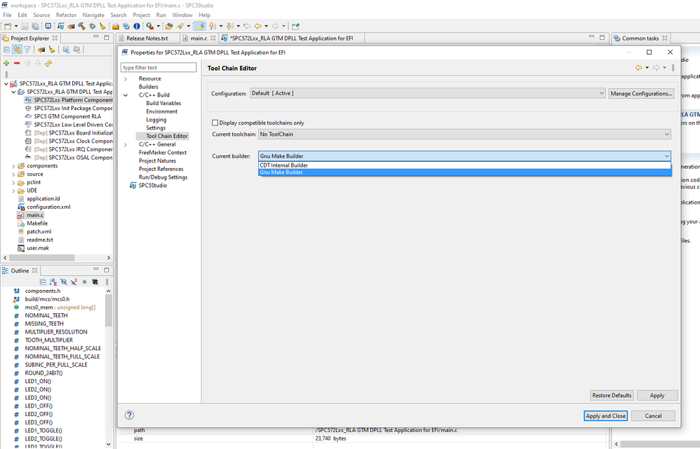

In the build settings for the platform component I have:
In the Tool Chain Editor I have several options for the toolchain but not the hightec compiler, under current builder I only have the following:
