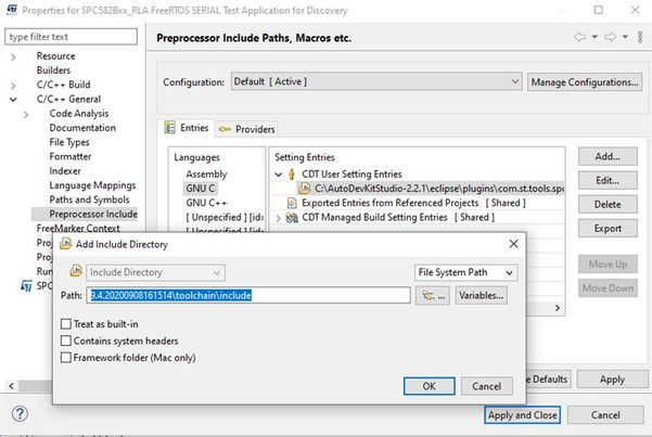

Max VIZZINI
You do not need the standard libraries in the code like <stdlib.h>.
In Eclipse and consequently in SPC5Studio, there is a pre-processor for the code compiling called CDT.
The issue is that the built-in CDT ''preprocessor" does not find the include PATH of the gcc compiler. It is just a preprocessor issue but does not affect the compilation.
If you want to remove these errors in C/C++ general ==> Preprocessor Include ==> CDT USER Setting Entries
enter:
C:\AutoDevKitStudio-2.2.1\eclipse\plugins\com.st.tools.spc5.tools.gnu.gcc.ppcvle.win32_4.9.4.20200908161514\toolchain\include
or equivalent path for your installation like C:\SPC5Studio....\eclipse\plugins\....
This should solve your issue.

Max VIZZINI
enter:
