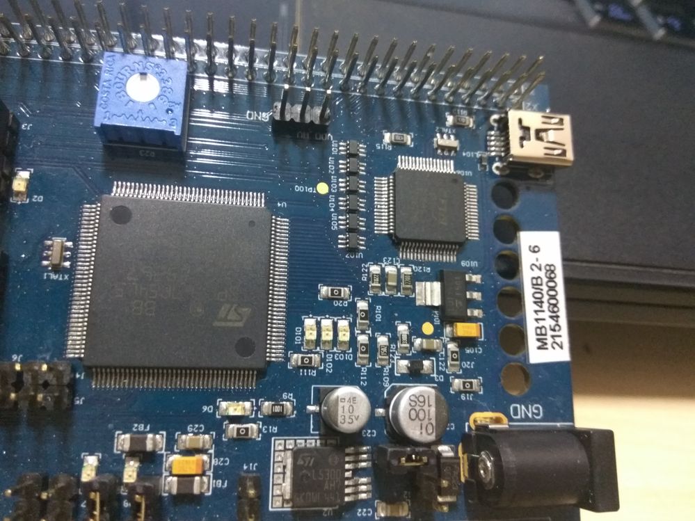

i am using the SPC560B-DIS development board with the spc5studio IDE.
all of a sudden when i tried to flash the development board i got an error in the log saying : Error, Core::PpcJtagTargIntf, Connection to target lost !
i suspected a loose cable to be the culprit but then the same cable works perfectly fine with the other EVM(evaluation board).Then i also checked the mini usb power/debug female port connector on the board which is fine as well.(did not see any physical damage on it attached is the image below).i have attached my boards log file from the UDE when i got the board connection lost error.

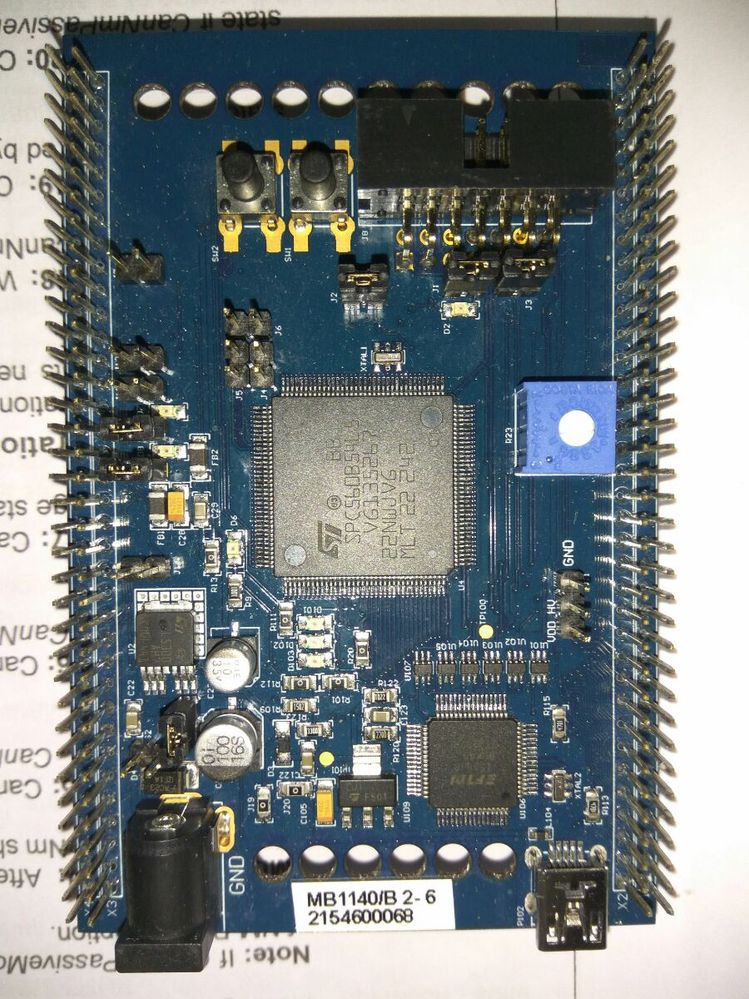

2017-03-03 5:59 AM
Hi Erwan,
Thank you for your valuable support appreciate your time.i am digging for any software settings or jumper settings that has to be taken care of to power the development board using the external supply instead of the debugger supply.is it need?
or can i just go ahead and power the board with a external 12v supply with the usb cable connected to the board for flashing the code.if you can guide me to a document which clarifies these questions it will be of a great help to me in the future to refer one.
and also have attached the pic of the whole board here in for the jumper settings reference.
Thanks and Regards,
Nishil.
2017-03-06 12:30 AM
Hi Erwan,
below is the attached image of the board with the LED's status during flashing the image.
and also, may i get a hardware debug procedural document for debugging this faulty board.
2017-03-09 12:30 AM
Hello Raj,
The Jumper settings seem to be correct.
Could you check the document B Discovery (cf Document) ?
You can try :
http://www.st.com/en/development-tools/spc5-udestk.html
Best Regards
Erwan
